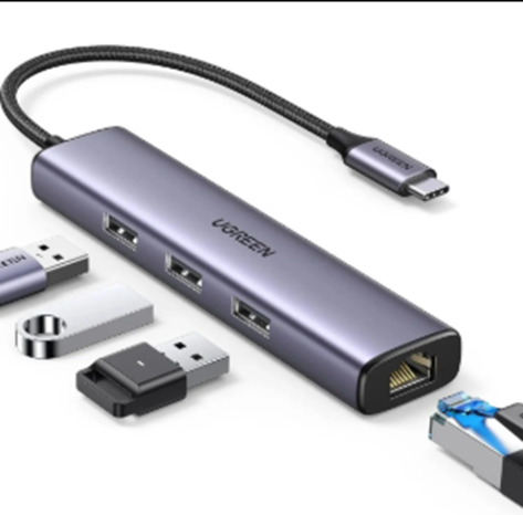

If you are limited to using a Mac, you can still proceed with the help of an external Ethernet adapter (please refer to the screenshot below).

Apologies for the inconvenience. However, we will need either a Windows laptop or a compatible Ethernet adapter for the Mac to proceed
