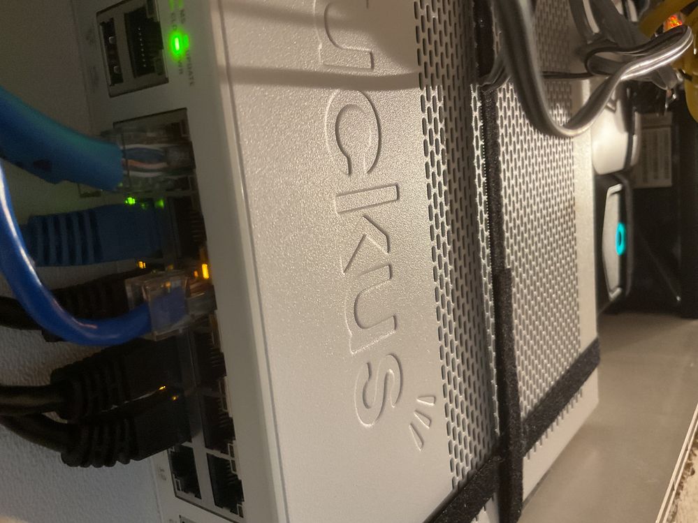

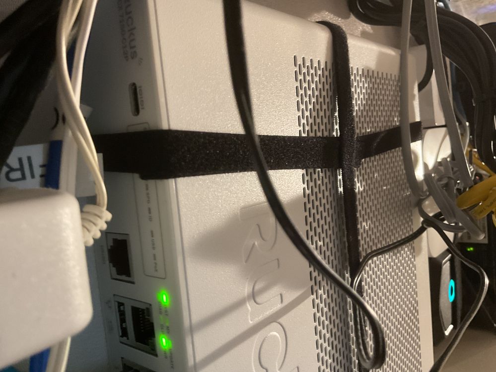

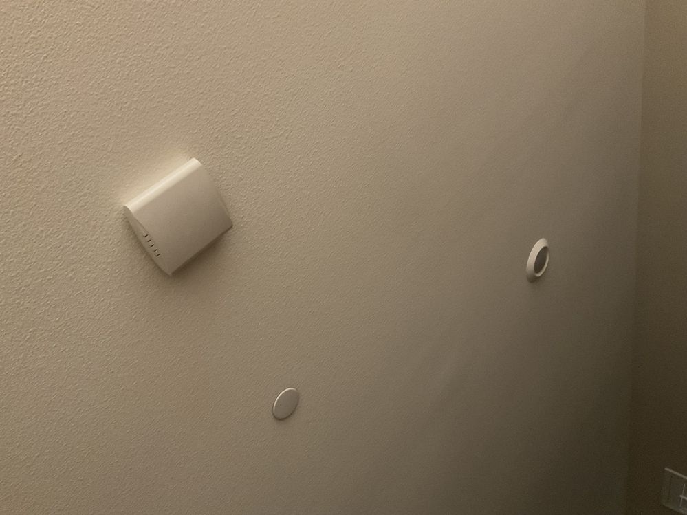

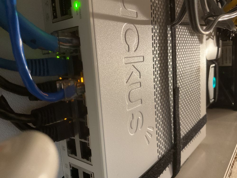

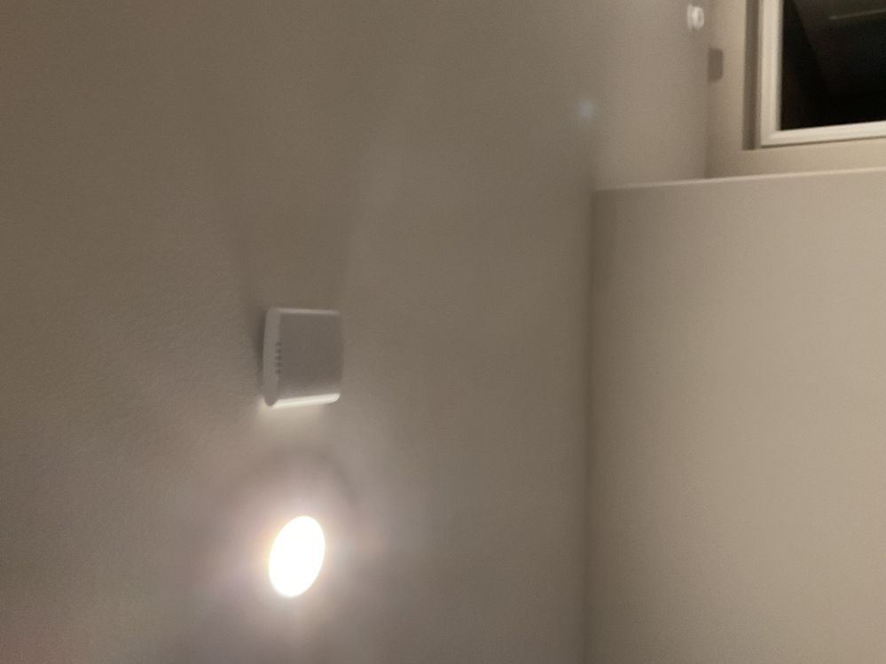

1. When your switch is connected to the outlet, do you observe any illuminated lights (amber or green)? Kindly describe which lights are visible. Additionally, please provide a photo showing the status of the lights and the full switch panel with cable connections to the switch ports.
2. How many access points are currently connected to the switch? Please describe the status of the lights on the access points. Similarly, include a photo showing the access points' light status.

I uploaded the photos. I have 2 access points. Neither have any lights. The switch has 2 green lights and 1 orange light. Due to the way it is mounted in my cabinet by the builder, I am not able to see the labeling of the lights. I had to lay on my back on the floor under the cabinet to get the picture. I also have video of us trying to reset the switch/access points, but this reply only let me upload photos.

Based on the current light status of the RUCKUS ICX-7150-C12P Switch, it appears to be operating normally.
However, the issue may be related to the switch ports being disabled, which could prevent Power over Ethernet (PoE) from being delivered to the Access Points.
