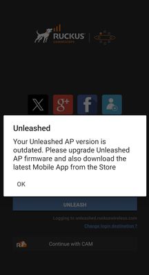

Hi Imran,
After much effort, I'm able to reset one AP. From mobile unleashed app, the configuration didn't work as the firmware versions are not supported. I then used web from laptop to configure the AP and could successfully create wifi. However, I'm unable to update the firmware or use the dashboard from web. I have now connected the other two APs from switch.

Based on your description, it appears that you are experiencing difficulty logging into the RUCKUS Unleashed application.
This issue commonly arises when your RUCKUS Access Points are running an outdated version that prevents access to the Unleashed application.

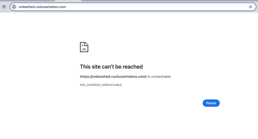

07-07-2025 06:13 PM
Hi Imran,
This is the error that I'm getting from web browser chrome (in macbook).

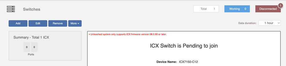

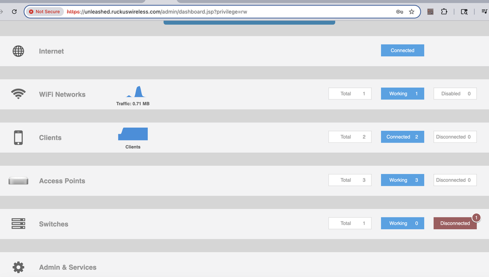

07-07-2025 06:40 PM
Update: I don't know how but the webpage login worked. I can see 3 APs working, however, the switch is disconnected. I tried to connect using admin credentials but it didn't work. It says that the current firmware is not supported.
How to update the switch firmware?
