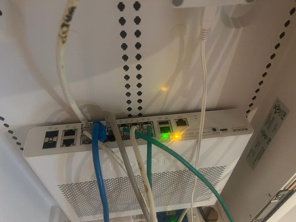

The steps were completed successfully (though I could see lots of crash messages on the console), still, the device only has 2 lights as shown in picture and wifi extender does not power on.

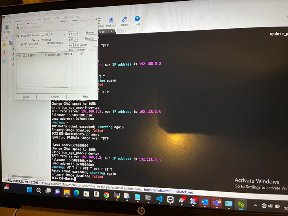

We did try the command:
setenv image_name SPS08090k.bin
update_primary
The error we get is:
Primary image download failed
08-01-2023 06:22 AM
Hi @sebastso
Thanks for your response.
Please share the screenshot of the error you are getting while following the steps.
08-01-2023 07:07 AM
At
Attached the screenshot, see the error:Primary image download failed
08-01-2023 08:34 AM
Hi @sebastso
Please enter the below commands and retry the software recovery process and share the output.
setenv ipaddr 192.168.0.3” (assign an IP address to the switch, As you see I just change the last digit instead 2 as my computer I used 3)
"setenv gatewayip 192.168.0.2" (default gateway of your network, which will be your own computer as well)
“setenv netmask 255.255.255.0” (net mask belonging to the network, matching with the same found from the CMD)
“setenv serverip 192.168.0.2” (enter the IP address of the TFTP server, means the computer wire to the Switch on the management port)
"printenv" (check the values you recently change)
- Enter command saveenv to save the changes
"saveenv"
“ping 192.168.0.2”
