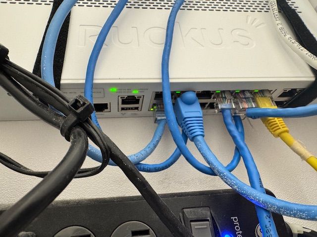

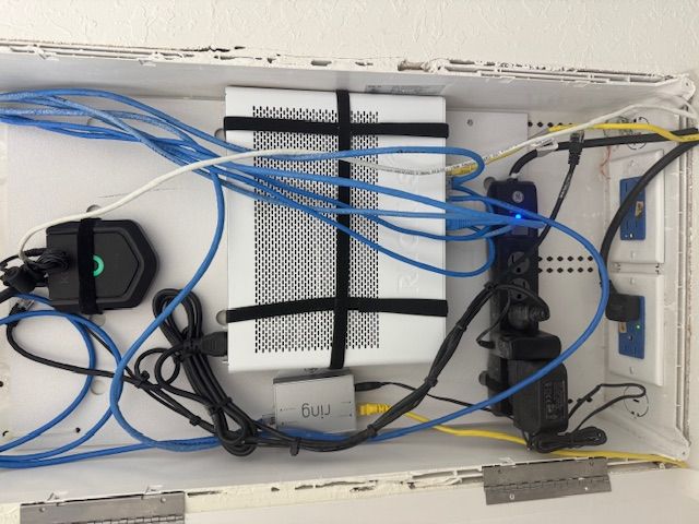

When your switch is connected to the outlet, do you observe any illuminated lights (amber or green)? Kindly describe which lights are visible. Additionally, please provide a photo showing the status of the lights and the full switch panel with cable connections to the switch ports.
Here are the pictures you requested.  Know the switch is protected by APC unit.  For things to work I have to bypass 1 of the 2 APs I have using a POE injector.    If I connect both internet will drop more due to the switch failing.  I have to restart the switch constantly.   I was trying to connect to it now and give you some output from the switch but it fails.  For me to be able to get in I would have to restart multiple times.
