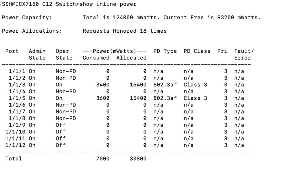

Please try to unplug the cable of the master AP and plug into one of the 12 ports of the switch and check the speed.
Also please share the output of the following command.
"show interface brief"

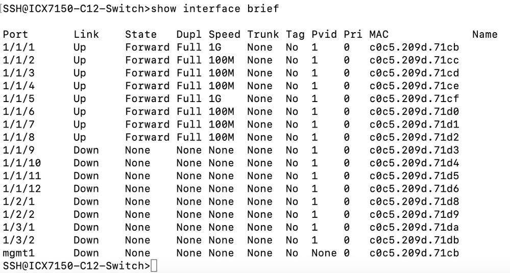

I have already tried swapping the ports between master and member AP's on the switch but it didn't help.
Here's the output of "show interface brief"

Hi @RuckusIssues
Thanks for your response.
Based on the outputs seems like that the device that is connected to the Switch have a bad cable. This can affect performance causing the speed to be very slow through that access point.
Please try to replace the cable with a good one.
10-05-2023 03:09 PM
This is for other folks who may come in later trying to find resolution to similar problem.
Instead of replacing the wire (which was sandwiched between 1st and 2nd floor) I tried to replace the RJ45 connectors of the supposedly faulty cable going from Switch to AP. I ordered an RJ45 crimping kit off of Amazon to clip both the ends and put new RJ45 connectors on it and that did the trick. So now I have 1gig speed on both AP's.
