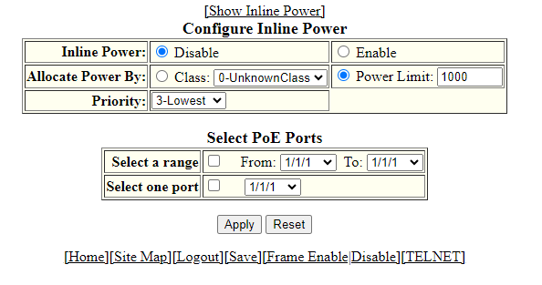

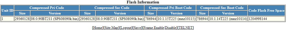

Hello,
Both the AP's are connected to Switch using CAT6 cable. I've checked these values from UI. Please see the screenshot below.
