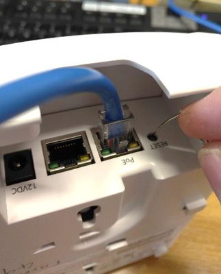

I followed these instructions:
 Vásquez_Fer
‎10-20-2022 01:57 PM - edited ‎03-05-2024 04:49 AM
Please read carefully all the instructions before proceeding.
1 ) If you have more than one Access Point (AP) in your house, please go to the Ruckus Switch (located in the panel) and disconnect from its ports the Ethernet cables of all the Access Points, except the one that you are going to work with.
2) It’s preferred to keep connected to the Switch the Access Point that is acting as MASTER. You can recognize which is this device, because is the only one with the CTL light in SOLID green.
Link: https://docs.commscope.com/bundle/unleashed-200.14-onlinehelp/page/GUID-19D4261B-D10B-4DE3-B63A-3498...
3 ) After you made the previous steps, go to the Access Point that is still ON, and find the RESET button that is in the rear side of the device.
4 ) Introduce a paper clip or a similar implement and push the button. Once the Power Light is red, count 15-20 seconds  and release the button.
Note: Sometimes this process has to be done more than once in order to have the Reset Factory properly done.
5 ) After the reset is complete the PWR LED  will initial be solid red indicating boot up in process, then blinks green light indicating that the system is in factory default state.
6 ) A new wireless network should be displaying :
The name of this new Wi-Fi network is 'CONFIGURE.ME-XXXXXX' (the X represents the last 6 digits of the MAC address of the AP). You can customize this network easily using the Unleashed Ruckus App that you have to download to your phone.

Hi @mst317
I apologize for any inconvenience this may have caused. When performing a factory reset on the Access Point, please press and hold the reset button for approximately 20 seconds. During this process, the PWR light on the Access Point will turn RED, and it will broadcast a "configure.me-xxxxxx" network, indicating that the reset process is underway.
To remove the Access Point, please use a paper clip to unmount it. For guidance on this procedure, you may refer to the video linked below, starting at the 3:30 mark:
https://www.youtube.com/watch?v=vFD_ByQWGH0&t=42s
