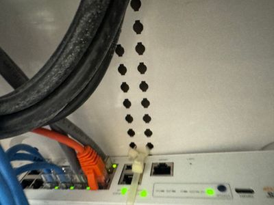

All lights are green on switch and 3 access points

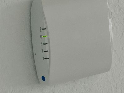

4. How many access points are currently connected to the switch? Please describe the status of the lights on the access points. Similarly, include a photo showing the access points' light status.
Please upload these photos to your RUCKUS account before proceeding.

System has worked fine for nearly 4 years. We were out of town and when we returned, it was no longer working. I know that Comcast had an outage while we were gone.
All switch lights are green. I have 3 APs. All lights are green. AP #1 CTL solid green and PWR flashing green. AP #2 & #3 CTL and PWR flashing green.
No problem with the Comcast Internet. It’s stable and working great.

Could you please try unplugging ALL the Ethernet cables of the Access Points from the current switch ports and plugging them into different ports within the 1-to-12 range, as indicated in the screenshot below?
Once you’ve done this, please check if the status lights on the Access Points indicate activity and if the Wi-Fi network connectivity is restored.
09-02-2024 06:55 AM
I placed all the Ethernet cables into 6-12. All switch lights are green. AP #1 CTL solid green and PWR flashing green. AP #2 & #3 CTL and PWR flashing green.
09-02-2024 07:06 AM
I now have 3 networks showing up that are callled Recover.Me-xxxxxx. Are these Ruckus related?
