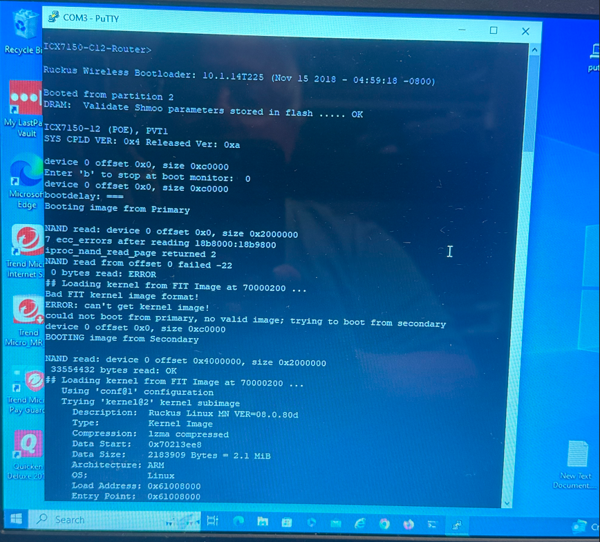

I had a power outage yesterday and when the system came back up the Ruckus ICX7150 was showing intermittent internet connectivity, and I am unable to connect to it using the Unleashed app on my phone. When I console in with putty, I see this prompt "ICX7150-C12-Router", which indicates that it is in router mode. I attempted to reboot the Ruckus ICX7150 from the Primary, using the command "boot system flash primary yes" but during the boot process I see the error message "could not boot from primary, no valid image; trying to boot from secondary". Any assistance on how to proceed would be greatly appreciated.

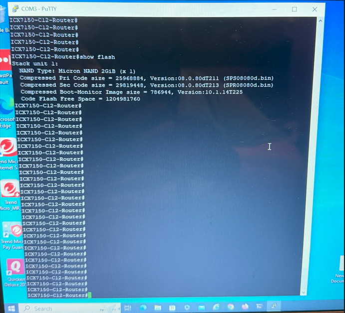

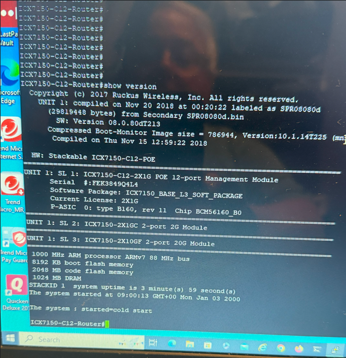

Hello @Lewthound ,
Could you please share the screenshot of the error message along with the output of the show flash command so that we could assist you further?
Lewthound
Below are screenshots of the of the error message, the show version command, and the show flash command you requested. Let me know if you need any additional information.

show version
show flash
