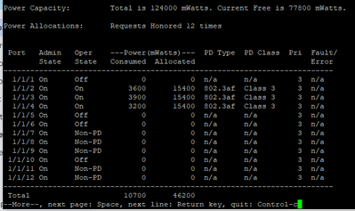

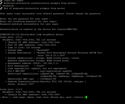

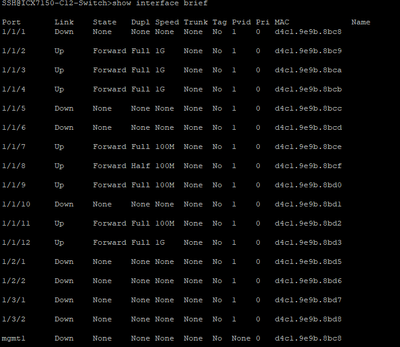

Here is what I get when I run the commands you asked me to run...

As per the Switch commands output you shared, everything seems to be fine.
