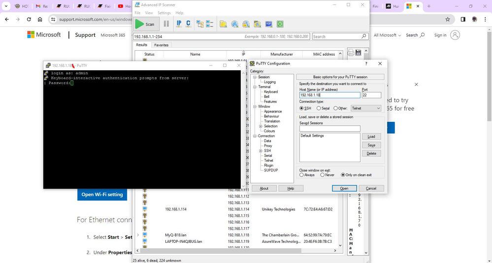

I have tried this both ways. 23 does not work and 22 does. I can get to the password but the passwords provided in the document do not work. Putty 1.JPGputty 2.JPG

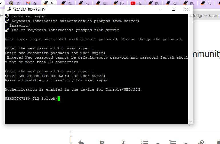

Hi @Chrisdsax
Could you please try to log into the Switch CLI using SSH by the default credentials?
Switch default credentials will be as mentioned below.
Username: super
Password: sp-admin
If the above credentials don’t work, you can try below default credential combinations as well.
If any of the above credentials doesn’t work, please try to factory reset the RUCKUS ICX-7150-C12P Switch as described in below VIDEO and once you perform the reset try to login with the above-mentioned default credentials again.
VIDEO link: https://www.youtube.com/watch?v=6jHMTdo_hK4
That worked!!!! LOL!!! Thank you... I am in. I will let you know how this turns out.putty 3.JPG

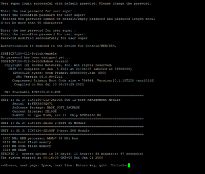

ok so I did the show version and this is what I get. It is just here and I cannot do the show flash.

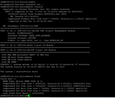

Ok so now this is my show flash
