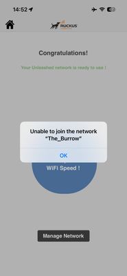

I was able to factory reset successfully using the power adapter. I went through the configuration process, but the AP is not broadcasting the SSID I gave it. Even after 10 minutes of waiting it’s still only broadcasting the configure.me network.

Yes, it’s not broadcasting the SSID you configured maybe because you are not connected to the Internet by AP. The main purpose was just to confirm if you can factory reset the AP using the power adapter. As you are able to perform it successfully, meaning AP is working normally.
