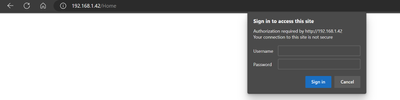

08-14-2023 07:00 PM
Hello,
I tried the Console that you showed, and it does not work with any accounts or passwords listed in the article. The 'admin' account does log me into the other console I showed you, but not this Web Management Console. The 'admin' account I have the password for and lets me login into the putty session, but the commands you asked me to run don't work.
No combination of accounts/passwords work here.

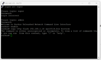

Here are the IP Addresses from IP Scan
Using SSH to connect to the 192.168.1.25 address and 'admin' account, the only one that lets me login. The copy command does not work.
What next?
Thank you.
08-15-2023 08:17 AM
Hi @LenRuck2023
The Putty CLI screen you are logged in to is of RUCKUS Unleashed Access Points, NOT the ICX Switch.
Please use Telnet using the IP address shown in the below screenshot. And try to log in on Putty.

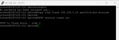

08-19-2023 11:14 AM
I connected to the switch using the telnet port and got the prompt you were looking for. It still does not work.
Putty session, never asks for account/password info, just connects directly flash copy fails:

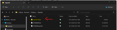

Should I be copying the .bin file in my upgrade folder?
