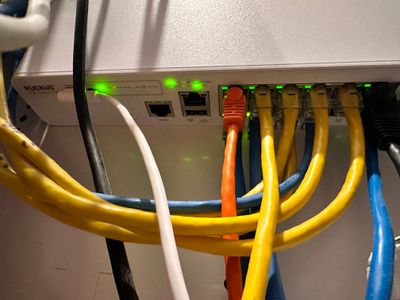

2. On your switch while it's plugged into the outlet, do you see any lights on? (Amber or green) Please let us know which lights are on. (Please refer to the below picture and share a picture of the same, showing the light status and the FULL Switch panel cable connections to the Switch ports)

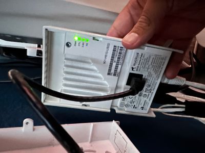

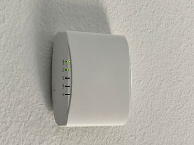

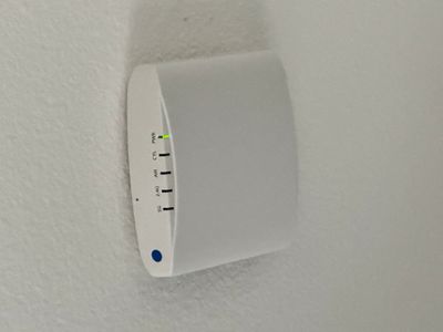

4. As you mentioned you have 3 APs connected to your RUCKUS ICX Switch. Could you please let me know the light status on ALL the Access Points? Any of these lights are on (Please refer to the below picture and share a picture of the same)

2. Here is the image of my switch

4. The Upstairs AP has a green flashing power light
 The Downstairs AP has solid power and control lights
the Office AP has a flashing green power light, but sometimes is solid red.

May I know to which port of the Switch your ISP (Internet Service Provider) Router/Modem-Router combo device’s ethernet cable is connected to? Could you please show it in a picture?

In the previously attached photo of the switch, my router is the orange cable plugged into interface 1/1/1
The three APs are plugged into 1/1/2, 1/1/3 and 1/1/4
