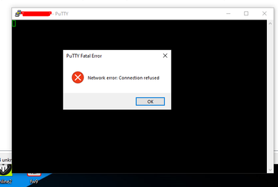

Telnet – Port 23 (If SSH doesn’t work)
This doesnt work.

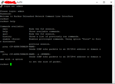

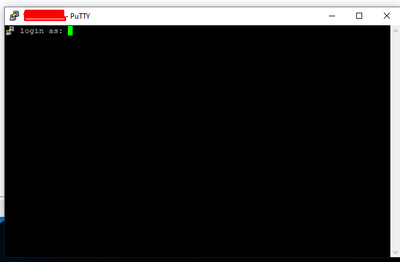

mbotkin
Login works but only for the WAPs. Haven't gotten a visible IP address for the Switch.

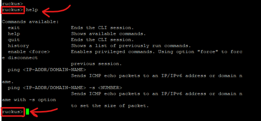

Hi @mbotkin
You are seeing the 'ruckus>' prompt (refer to the screenshot below), which indicates you have connected to the Access Point’s IP address rather than the switch.
When you access the switch, the prompt should read either 'ICX7150-C12 Router>' or 'ICX7150-C12 Switch>'.
You will see the Switch dashboard when checked in the web browser as shown in the screenshot below.
Please review the IP scan results for any entries listed as “Ruckus Wireless” or “Brocade Communications” to identify the correct switch IP address, then reconnect to the CLI using that address.
