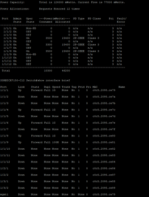

Yes I did all of the steps. Here is the paste:
05-19-2023 04:54 PM
Hi @Lennar010203
The output of the commands seems to be normal.
As we have performed some of the troubleshooting steps, please observe the behavior and check if you still get the heartbeat loss errors.
If you get them again, we have to perform a factory reset to the Access Points.
