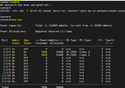

Note: in this example, I have executed the following commands
"enable" (maybe it's no required, only if you see the symbol >)
"show poe"
check that the Admin State all are as ON, with the Oper State will be on only if there is a device requesting PoE in my example are the ports 1/1/2 and 1/1/3
Note: If y the PoE is disabled, let me add the commands to enable it back.
"configure terminal"
"interface ethernet 1/1/1 to 1/1/12"
"inline power"
