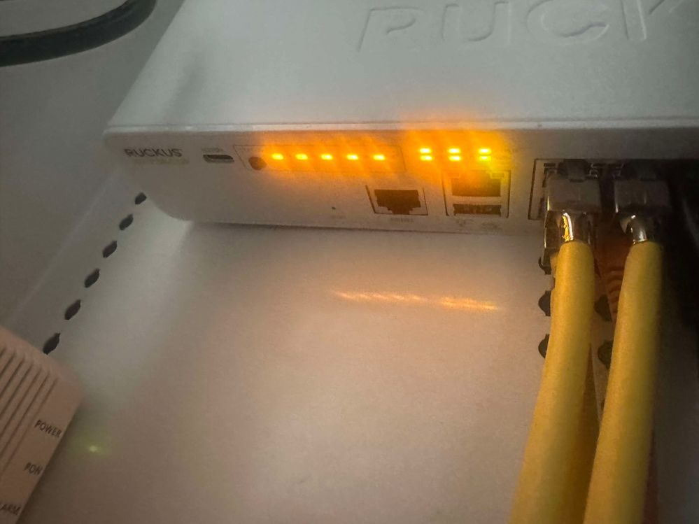

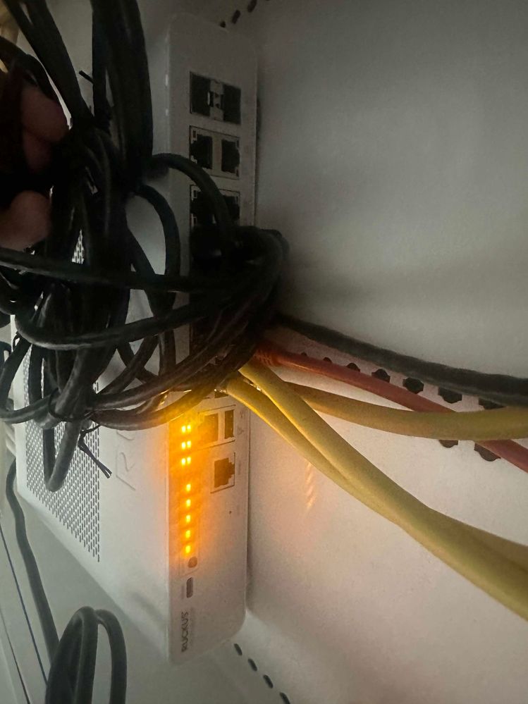

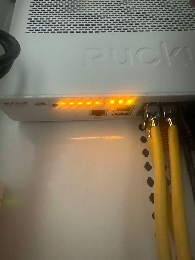

Before Reset, the PWR light is green but SYST is yellow. After reset it's all flashing yellow lights but it stays in this state indefinitely. I want to attach images but unlike your sample image there doesn't appear to be any option to add images.

Thank you for providing the information and the screenshot. Based on the screenshot, the amber light on the "SYST" indicates that the RUCKUS ICX-7150-C12P Switch appears to be stuck in boot mode.
Please try hard reset multiple times and check if the SYST LED turns green which is a normal indication. If that doesn't work please proceed with Software Recovery.
