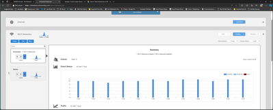

Imran, it seems you're not understanding what I'm asking. My router use to broadcast SSID = Dallas. I've now changed it to ASUS_98_2G or ASUS_98_5G. Are you stating that the AP (which was not changed only the Switch, save it's SSID as Dallas? If so, why can't I just go into unleashed.ruckuswireless.com/admin/dashboard.jsp, under Wi-Fi and just edit "Dallas" and change it to the SSID that I created for my router to broadcast (NOT MY ISP) to either ASUS_98_2G or ASUS_98_5G? There an edit function in ruckuswireless.com/admin. Why would I need to reset the AP to configure.me-xxxxxx SSID? Can I rename the AP SSID to configure.me-xxxxxx, or ASUS_98_2G, or ASUS_98_5G SSID instead of "Dallas"?

As I can see from the screenshot you shared, you have an SSID with the name ‘Dallas’ under the Wi-Fi networks in your Unleashed system which is getting broadcasted by the AP. As you can log into the Unleashed system you can just edit the SSID by selecting it and using the ‘Edit’ option. (Please refer to the highlighted screenshot below)

Iram, just so there's no confusion. I can use the edit command changing "Dallas" to ASUS_98_2G, or ASUS_98_5G... and a AP reset is not required.... correct?
11-03-2023 03:04 PM
Hi @dsmith160
Yes, you can edit the SSID and there is no reset of the Access Point required as you can access the Unleashed system.
