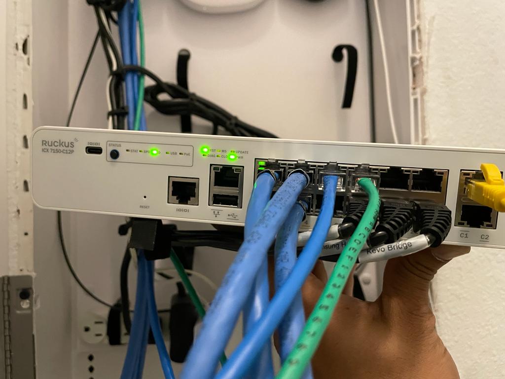

As per the case description, I understand that you need assistance as Internet Connectivity via RUCKUS devices in your recently moved Lennar home is very slow.
As per the light status of the RUCKUS ICX-7150-C12P Switch and the R510 Access Points, they seem to be in a normal status.
As I see from the picture you shared, seems like the ethernet cable which is coming from the ISP’s (Internet Service Provider’s) Router or Modem/Router combo is plugged into the wrong port on the Switch panel. It must be plugged into any 1 in-12 ports as shown in the below screenshot. Please unplug the ethernet cable plug it into the correct port and try to connect to the Internet via Access Points. If required, you can reboot (unplug and plug from the power outlet) your RUCKUS ICX-7150-C12P Switch and the ISP’s Router once.
Could you please let me know if you can connect to the Internet via the R510 Access Points Wi-Fi network or if you have any issues?
Please confirm and let me know if you have any queries in this regard.

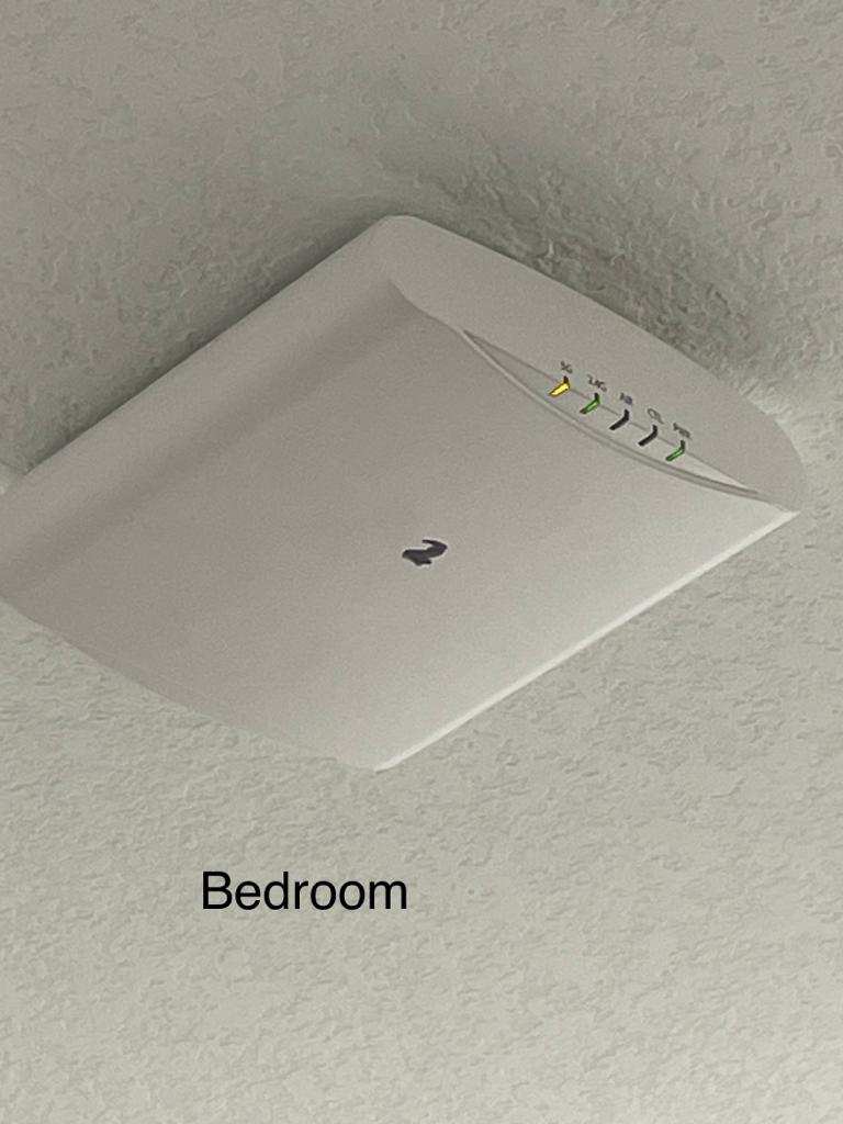

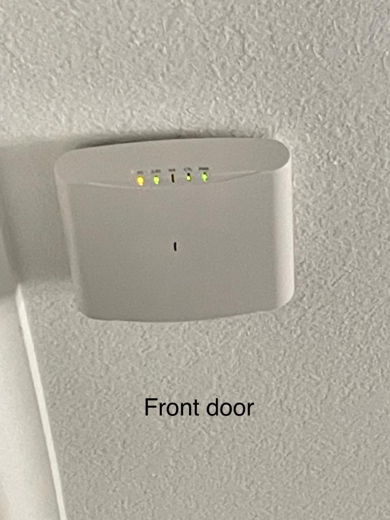

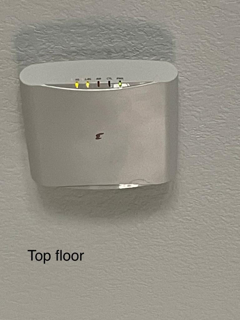

11-01-2023 04:48 AM
11-01-2023 04:51 AM
11-01-2023 08:15 AM
Hi @JacobKlutch
As per the pictures you shared, the Switch and the Access Points seem in a normal state.
