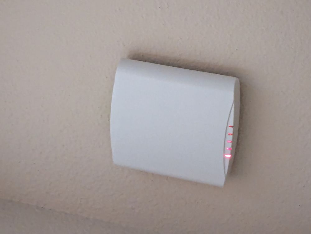

Hi, the Rucks r510 access point downstairs in my house is showing a Solid Red Light (the PWR Light). The one upstairs is working fine. We have attempted the physical reset process a few times and that does not render any different results. I've also pulled out the ethernet cable connected to the access point and plugged it into one of our laptops and confirmed that w/wifi access turned off on my laptop, that the ethernet cable is indeed delivering internet.
Is it likely that I may need another access point, or is the solid red light indicating that its stuck in reboot mode? Again, i've tried the physical reset several times and that has not worked, i've also tried to access the console within the Ruckus App, but the ruckus app will not allow me to login.

From the case description, I could understand that one of your APs is showing a Solid Red Light for PWR and you tried to reset it however, there is no luck.
Thank you for sharing detailed information.
Could you please disconnect the power of your ICX-7150-C12P Switch and power it on again? And once it boots up, please check the AP again.
Please refer to the process of a Factory reset of the AP Just as a reference:
Physical Factory Reset an RUCKUS Access Points:
https://community.ruckuswireless.com/t5/RUCKUS-Support-for-Lennar-Homes/Ruckus-Unleashed-Set-up-usin...
Please refer to the below Video for the initial setup which also includes resetting of Username and Password.
If that doesn’t work, please share a picture of AP showing the light status.
