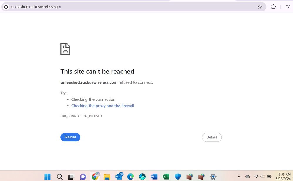

I tried this just now. On my laptop I connected to configure.me, then I in a new web browser I typed in :unleashed.ruckuswireless.com
I tried this on 3 different browsers: Chrome, Microsoft Edge and Wavebrowser
here is what happened:
