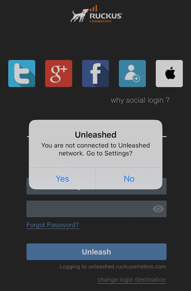

Thanks for your help. My access points are updated to the latest version of the firmware. I am able to access them through a web browser when connected to my local network.
The issue is that I can no longer access remotely through the iOS app. See screenshot of the app below.
Error message when logging into app
