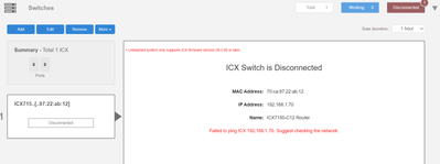

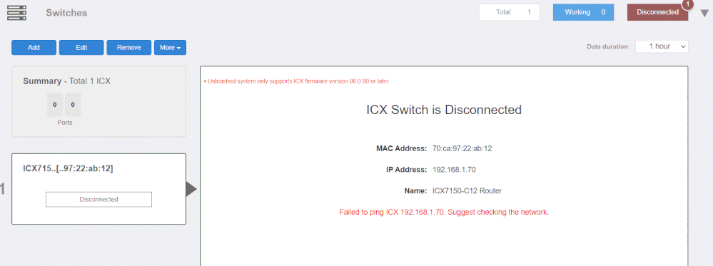

Can someone send me the steps to resolve the below issue?
12-12-2022 05:53 AM - edited 12-12-2022 05:55 AM
Hello
I can see that your switch is on the wrong partition (it says Router)
To Fix this issue please see below:

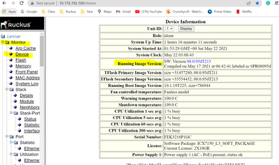

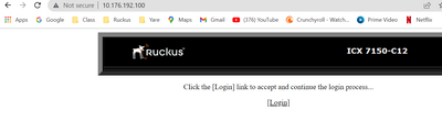

Or you can try to access via the switch's IP address:
While your computer or phone is connected to the Unleashed network, search the IP address of your Switch>open a browser and paste the Switch IP address Monitor>Device
Note: you can use the next guide to find the Switch IP address:
