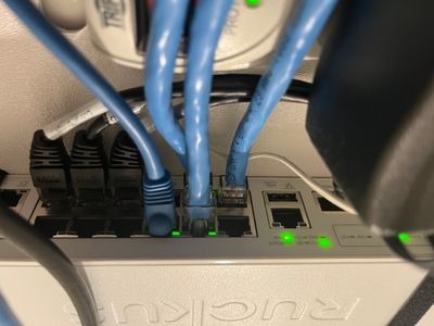

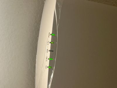

Hello,
I have the RUCKUS ICX 7150-C12P set up in my Lennar home and I am having issues with the wifi connection intermittently working and slow connection. I have tried to reset it by pushing the reset button on the device, powering off and on again with no success.

As per the case description, I understand that your RUCKUS setup is not working with intermittent and slow Internet connectivity.
As per the light status of the RUCKUS ICX-7150-C12P Switch you shared, it is in a normal state.
This issue may happen when the Switch runs on the Routing code (SPR). The Switch should run on the Switching code (SPS) to avoid these issues for Lennar home users. If the Switch boots up on the other partition (Due to a power outage/power spike) which may be running on a ‘Routing Code’ results in causing this issue. To check the same please follow the below process.
