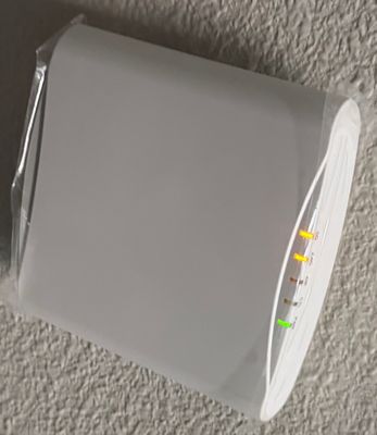

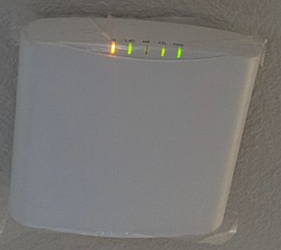

My Ring, Lutron, Access Points and others are getting power and working. The APs are showing orange color; do I need to update anything? Thank you for your help.

I'm glad to hear that the issue has been resolved.
Please note that amber LEDs on the 2.4 GHz or 5 GHz indicators are normal behavior for the RUCKUS Access Point. When these LEDs are amber, it indicates that the wireless radios are operational but there are currently no client devices connected. Once a device connects to either the 2.4 GHz or 5 GHz radio, the corresponding LED will turn green.
