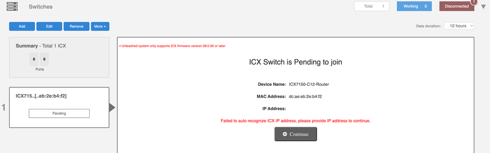

Able to connect to 3 of APs but, Internet keeps dropping.
01-02-2023 09:47 PM
After power outage RUCKS ICX 7150 C12P Switch does not work.
01-02-2023 09:49 PM
Already performed RESET. But it didn't make any difference by following below steps.

Hi @abhishek100
Hope you are doing well!
If there was a blackout or power outage and the switch reboot because of that, most possible your switch starts running the wrong code which we call ‘routing code’ this is a know issue.
MAC address: Physical address of the device this never changes
An IP address is a unique address (logical) that identifies a device on the internet or a local network like your home (this can change and may not be the same as the one shown on the dashboard)
1- To fix this issue, we must identify the ‘currently’ IP address assigned by your local router to the switch
-We can try the IP address that shows in the dashboard copy and paste it in the URL if that redirects you to the login page for the ICX-7150-C12P that is the correct one if not.
I will leave you a guide how to perform an IP scanner on your local network to identify the switch IP address very easily.
2-Once we identified the IP address of the switch proceed to access remote to the device 'command Line'
If you can access to the Command line should look like this:
ICX7150-C12 Router>
3-Here is a quick guide to understand how to fix the 'routing code issue' but basically you need only need to run the following commands once you are on the command line 'CLI'
copy flash flash secondary
example:
ICX7150-24P Router#copy flash flash secondary (hit enter to accept the command and wait: until the flash finished )
ICX7150-24P Router#boot system flash secondary yes ( hit enter to accept the command : the switch will reboot )
Or WEB access option
4-If the access via IP address is not possible here is a guide how to access to the Switch via console (cable access between your PC to the ICX 7150-C12P) in this case we need a USB type C to USB standard or Console cable Rj45 to USB.
Once you are log in the ICX-7150-C12P please follow up the same steps that are on point '3'
