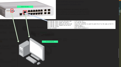

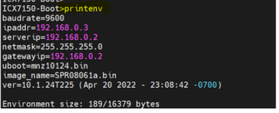

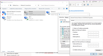

Take in consideration that the connection from the Out-Of-Band port in the Switch to the Computer Ethernet cable, is how you will be able to ping from Switch to the Computer, so please share a picture while the Switch is connected to the computer, also share the printenv command from the Switch and the computer the static configuration for the IP address.
Network connection>Ethernet>Internet protocol version 4>IP set up

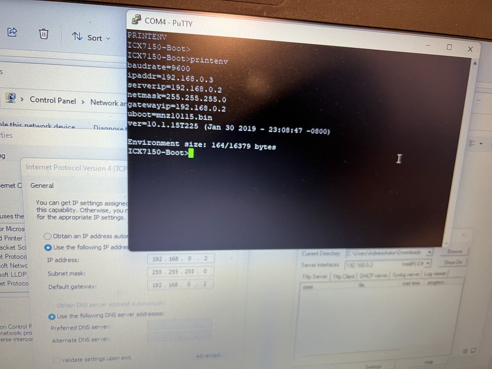

01-02-2023 05:32 PM - edited 01-02-2023 05:45 PM

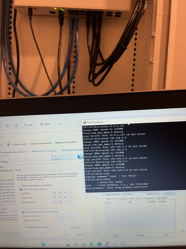

Yes, please see the screenshot. It shows ping command in Putty, IP address config in Windows and ip on TFTP. The RJ45 is connected from the Out-Of-Band port to my ethernet port in my laptop (not pictured).
01-02-2023 05:43 PM
Here's one of the printenv.
01-03-2023 08:14 AM
Hi @itjason916

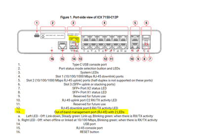

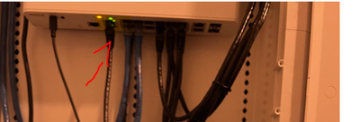

I can see that the configuration is fine, however, what is that black cable that is connected to the USB port, what you need is an Ethernet cable from the Out-Of-Band to the Ethernet port on the computer, this is the one that create the connectivity to perform the software recovery, in the guide it is confirmed that the Out-Of-Band that is over the USB one.
Example:
