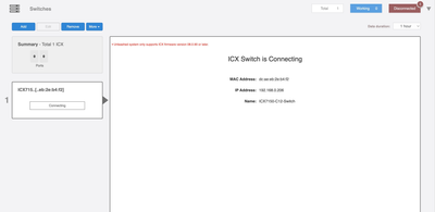

RUCKS-ICX-7150-C12P Switch does not work.
abhishek100
Able to connect to 3 of APs but, Internet keeps dropping.
6 REPLIES 6
thanks!! Internet seems to be working. But switch still shows disconnected.

In order see the ICX in the unleashed app is a bit tricky because you must generate a ssh tunnel so in simple words is like private tunnel between the access points and the ICX.
1-Make sure the Switch is on version 8090 later firmware version
https://docs.commscope.com/bundle/unleashed-200.9-onlinehelp/page/GUID-A446EC1D-FC2C-4546-BE26-FDE4C...
2-Make sure the management approval is enabled
https://docs.commscope.com/bundle/unleashed-200.9-onlinehelp/page/GUID-A887C55E-6973-4496-9413-302E8...
3- It would be great if you enable LLDP/RSA protocol on the switch side here is the commands:
Device>enable
Device#config terminal
Device(config)#lldp run
Device(config)#crypto key generate rsa
Edit the current password and username
device(config)# username super password pass
Where the username is ’super’ and password ‘pass’
Unleashed dashboard
1-Hit Add on that dashboard
2-Put the IP address of the ICX switch
3-Username and password for Switch authentication that we created
https://docs.commscope.com/bundle/unleashed-200.9-onlinehelp/page/GUID-30C6694A-6AEE-4DF8-9459-1AB18...
To sync the data, it will take us a while, so after a couple of minutes it should say connected
