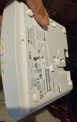

02-03-2024 11:14 AM
please find attached
02-05-2024 04:39 AM
Hi @VKTechGuy
As your RUCKUS AP is powering up using a 12 VDC external power adapter, maybe the ethernet cable connected between this AP and the RUCKUS Switch is defective. Please try to replace an ethernet cable with a working one and check.
Please check and confirm.
02-05-2024 06:26 AM
I have swapped the AP with one that is working and I do not see an issue with cable.
02-05-2024 07:00 AM
Hi @VKTechGuy
If your ethernet cable is working fine, this issue may be due to some Switch ports getting disabled.
Please refer to the below RUCKUS Lennar Knowledge Base self-help guide to check and troubleshoot this issue.
02-05-2024 01:58 PM
I do not believe that is not the case... the working AP is powering up from both locations (both cables are working and ports are enabled)
