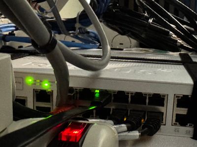

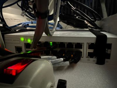

On your switch while it's plugged into the outlet, do you see any lights on? (Amber or green) Please let us know which lights are on. (Please refer to the below picture and share a picture of the same, showing the light status and the FULL Switch panel cable connections to the Switch ports)
Beanwinker
I am trying to take photos but the unit is mounted in a cabinet with all the other equipment in the Lennar system.   The Switch is upside down so hard to get a photo.  The only thing without a light  on is the cable going to the AP in the living room.  Hope this helps.   - Sid

Thank you for the response you shared.
From the pictures you shared, the lights on the Switch is normal and switch is working and there are no lights in the access points, it is always good to check if the PoE is disabled or not.
Please follow the below RUCKUS Lennar Knowledge base self-help article which will help you to check if the PoE is disabled and to fix the issue if it is disabled.
