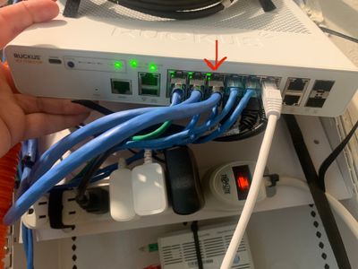

Could you please let me know to which port of the RUCKUS ICX-7150-C12P Switch the affected AP is connected? Please share the picture of the same, as shown in the below screenshot.

08-28-2023 09:18 AM
The arrow is pointing to the AP that is not working.

The connections and light status of the Switch seem to be normal, now we may need to factory reset the APs to configure them with a new SSID.
