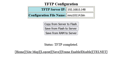

I successfully uploaded the new 08.0.95g configuration file via TFTP and the web interface confirmed completion. When attempting to save the configuration (Save → Yes), I consistently receive the error:
"Flash access in progress. Please try later."
I have tried rebooting the switch and repeating the process, but the error persists.

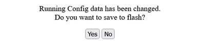

I am getting stuck at G.1. Here is a screenshot of the error:
Then I click Save and then Yes and I get this error:
When I click Logout, I get this and have not responded to it:

I understand that you are unable to complete the Upgrade process through GUI.
As you have access to CLI, I would request you to please complete the Switch Upgrade process through Switch CLI.
Please follow the below RUCKUS Lennar Knowledge base self-help article which will help you to upgrade the switch to the recommended version
Please follow the process explained in the article and use the option 1 through CLI and let me know if you have any queries in this regard.
