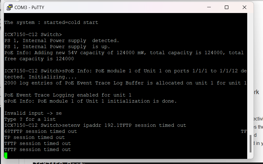

Just establish an account. Email address [email protected]. Sorry for the duplicate issue. Bought a new construction townhome with Lennar in May 2018 with the Ruckus wireless system pre-installed in my house. Recently, had inclement weather and both the upstairs and downstairs R510 access point units no longer have power. The ICX 7150-C12P seems okay but the ports that both R510s are plugged into do not respond.
Need help please,

I made another attempt to RESET the 7150 following the described procedure exactly. Again it failed. I was able to establish communications wuth the 7150 sing PUTTY and this snatshot is after the power was re-established and the Reset was attempted. I saw TCSD up and running, partitions established, and loading of the SPS08061A image. It doesn't seem to allow a software recovery without this procedure completed. I have spent several hours trying to follow procedure but I keep hitting stone walls.

I believe I am still having problems because I can not get to the boot> As you can see from my attached picture I am coming up at ICX7150-C12 Switch> I start to type trying to set the IP address etc and the session times out. I think it's because I can not do a RESET. The unit just will not reset I have followed the instructions over a dozen time but it will not reset to a BOOT>
