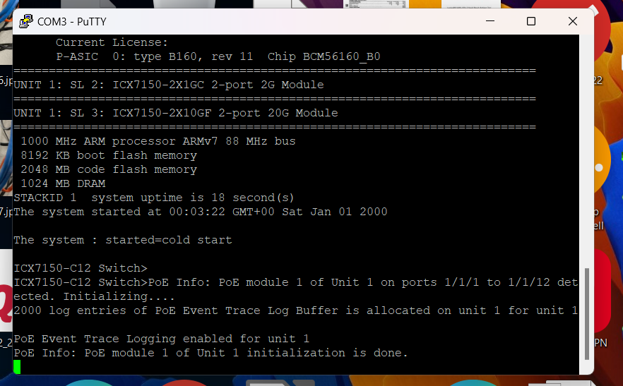

I made another attempt to RESET the 7150 following the described procedure exactly. Again it failed. I was able to establish communications wuth the 7150 sing PUTTY and this snatshot is after the power was re-established and the Reset was attempted. I saw TCSD up and running, partitions established, and loading of the SPS08061A image. It doesn't seem to allow a software recovery without this procedure completed. I have spent several hours trying to follow procedure but I keep hitting stone walls.

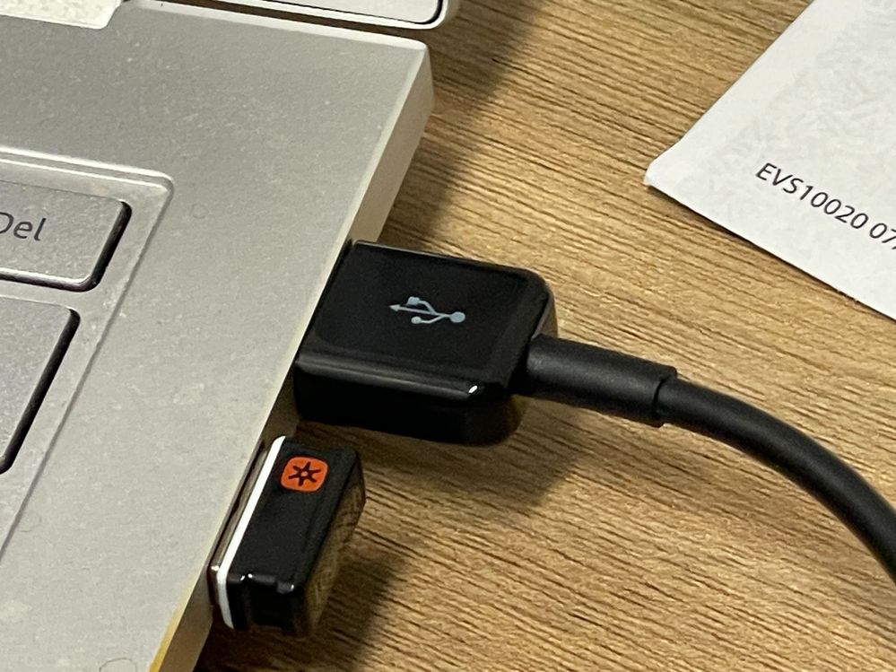

Please provide an image/photo where you are trying to connect via console / Ethernet  from ICX 7150 - C12 P (USB type C to USB ) to PC. ( Physical setup ) like the following example :
Before uploading the photos please login to the RUCKUS account and you can upload the image.
Hi @FET4771
Based on the images you have shared it seems that you have connected only to the console port of the switch. Please connect the ethernet cable to the management port of the switch using the below guide.
Once you are done with the connections please try performing the software recovery process.

I believe Screenshot 2023-05-01 192208.pngI am still having problems because I can not get to the boot> As you can see from my attached picture I am coming up at ICX7150-C12 Switch> I start to type trying to set the IP address etc and the session times out. I think it's because I can not do a RESET. The unit just will not reset I have followed the instructions over a dozen time but it will not reset to a BOOT>
