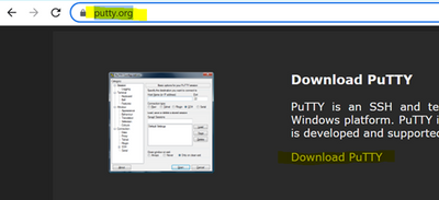

- Now we are going to download two applications to gain access to the Switch, Putty and TFTP(Part 2)
Putty: https://putty.org/
TFTP 64: https://bitbucket.org/phjounin/tftpd64/downloads/
Second Link for TFTP 64: https://github.com/peacepenguin/tftpd64/releases
