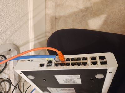

  • Is the switch powering on when you use the normal source instead of supply or connection which uses solar power ? Have you tried checking that.
  • Could you please let us know if you see any LED indication in front panel of the switch ?
  • Could you please share pictures of front panel and rear end of the switch when connected to normal power source and solar power source ?
Thanks
I had NV engery come out and switch it back to there engery. I also had them look at the unit to see if they new anything about it. They said that they unit must of just went out. Everything else in the home is good. Nothing else I the home went out.
Hi @Tiamemachine
I can see that the switch has power and there are lights on PWR and SYST, if there is an amber/orange light on the "SYST" and a green light on the "PWR" on the Switch (as it is in the below picture). Meaning the Switch is stuck in the boot mode.
Basically, due to the power outage/ power spike, the switch went to a state that we call ‘boot mode’ that is not able to boot up properly. And this is the reason your RUCKUS ICX-7150-C12P Switch is unable to transmit power (PoE- Power over Ethernet) to the Access Points or on its ports.
