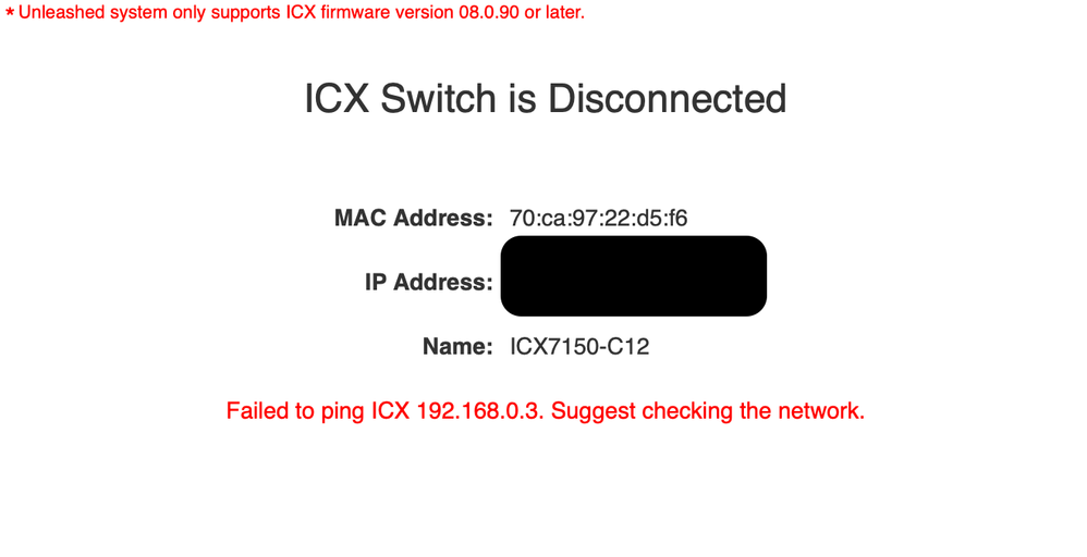

Hello! I am having the same issue at the end of the day where the switch is showing disconnected. In the unleashed portal, the error message reads: Failed to ping ICX [IP ADDRESS]. Suggest checking the network.
The WIFI from my Century Link is still working and I am connected it.

Hi @DretheGreatX
Based on your description it seems that on your ICX-7150-C12P Switch, the SYST and PWR lights are steady green, which means the lights are in a normal state.
Since the switch is in the normal state you can take Console access to the switch in order to verify, if the switch is able to connect properly to Access Points or if it has a ‘Routing Code’ issue which happens due to power outages most of the times, this is a known issue for Lennar home users.
-MAC address: Physical address of the device this never changes
- An IP address is a unique address (logical) that identifies a device on the internet or a local network like your home (this can change and may not be the same as the one shown on the dashboard)
Please follow the below steps:
ICX7150-C12 Router>
show version
copy flash flash secondary
(Please share the output screenshot of the ‘show version’ command)
Example:
VIDEO LINK AS REFERENCE: https://www.youtube.com/watch?v=Eem1IBgYaWc
ICX7150-24P Router#copy flash flash secondary (hit enter to accept the command and wait: until the flash finished)
ICX7150-24P Router#boot system flash secondary yes (hit enter to accept the command: the switch will reboot)
There are Two ways to fix this issue:
I) How to Fix Routing code issues on Lennar Home users via CLI
II) Or WEB access option
Once you are logged in to the ICX-7150-C12P console please perform the same commands that are on point '3'
