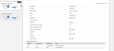

AP are currently running on firmware version 200.8.10.3.278. What is latest stable firmware version I should upgrade this. It need to upgrade in such way so that it maintain current configuration setup. I have attached screen shot of AP.

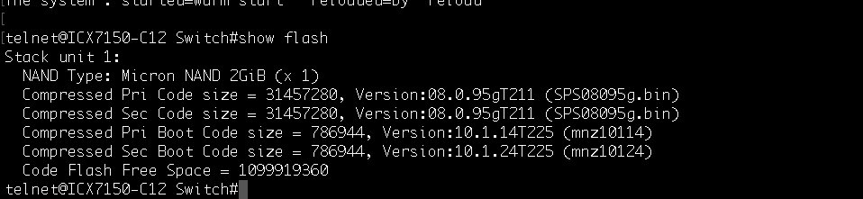

My switch is currently running on "08.0.95gT211" screen shot below.
AP Current firmware version:

The recommended stable version is 8095g and your switch is already upgraded to the latest version.

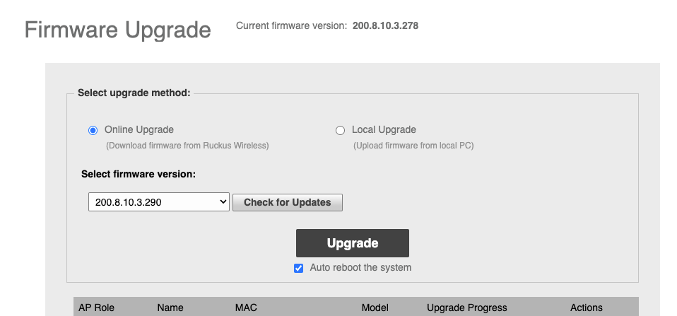

As your AP needs to be updated please upgrade the AP to the recommended version as mentioned in your screenshot you provided.
Please make sure that you upgrade all your APs to the same firmware version.
If not please check the versions of the APs as mentioned below and upgrade it to the same version 200.8.10.3.290.

Hello Jayavidhya,
APs are upgraded to the version 200.8.10.3.290.
Please let me know if this is final version or do we need to upgrade further.
07-31-2023 05:53 AM
Hi @saurabhk01
Please try to upgrade the Access Points to the version 200.14.6.1.199 which is recently released.
