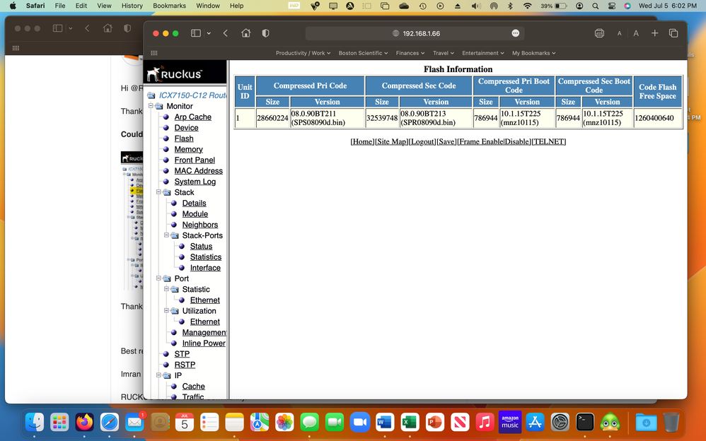

Hi @RL88
Could you please send me the following information as shown in the below screenshot?
07-05-2023 04:03 PM
07-05-2023 04:20 PM
Hi @RL88
Thank you for the information.
Please follow step-by-step screenshots below:
The Switch will take sometime to come up after reload.
