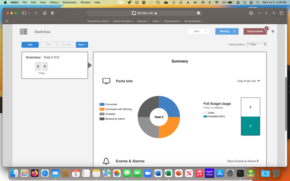

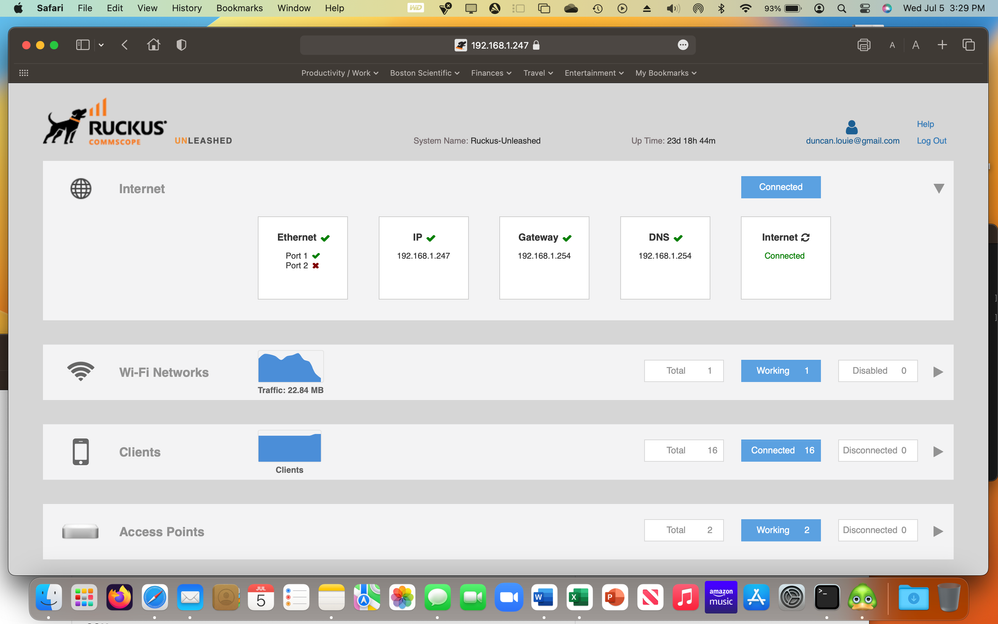

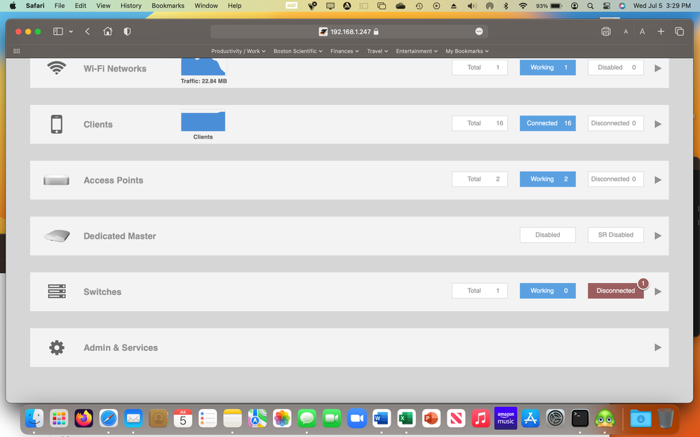

07-05-2023 01:42 PM
Imran,
Here is the latest. I was able to type in IP of switch and then log in with my credentials. Here are the screen shots.
