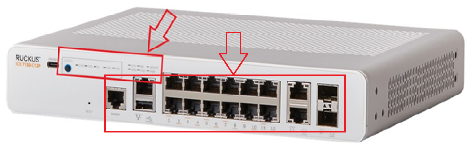

Could you please share the picture of the connection ports of the switch as shared in the below pic?
Also please confirm it the ethernet cable is plugged to one of the 12 ports in the Switch?

Hi, I took a picture of my setup, but the issue I'm having is random. I have no good way of taking a picture of the switch in the state, since most of the time it's working fine. Randomly, I wont get an IP address...maybe 1 out of every 10 times. Is there something specific you are looking for?
It also seems to happen at certain times of the day. Like most nights around 9pm, we'll see some sort of hiccup in the internet connectivity (This is across multiple devices in the home at the same time).
