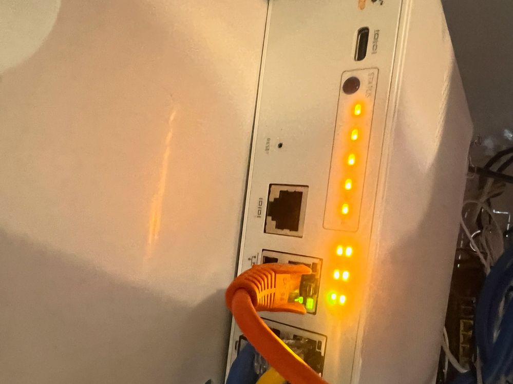

My power went out.  My RUCKUS POE is showing a green light for PWR and yellow light for SYS.  I have tried resetting over 10 times.  I tried going through the steps of the software reboot and that also didn't work/errored out when trying to do this.  Please help.

I understand that you've attempted multiple resets without success and tried performing the software recovery with the laptop connected.
Could you please specify the exact point where you're getting stuck? If you could share a screenshot, it would help us investigate the issue and assist you more effectively.
Nord
Hi, Here is a copy of the photo.  Trying to resend the screenshot errors from software reboot, however, I can no longer find the directions for doing it on a MAC.  Can you please resend those as well (all of the ones posted are for PC)
Here is the error when I reset.  It just keeps flashing these lights.
