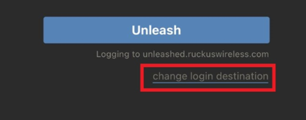

Hello, I was able to fix the app issue with others have said by changing the login destination at the very bottom to the IP address that was previously instructed on how to find.

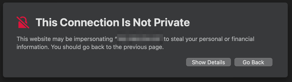

This workaround worked for me. Here's how it went for me.
