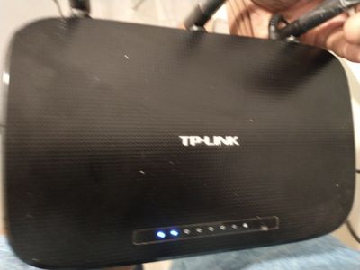

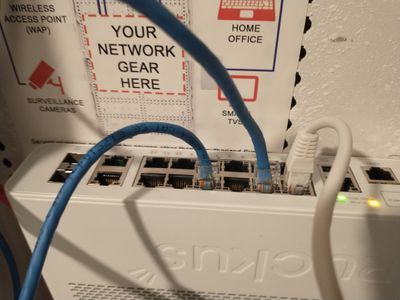

 i have attached the pictures of current setup above. Blue cable is connected to at&t modem from the master bedroom. White Ethernet cable is connected to the router. The light indicator for Internet is not on.
Whereas, see below picture. I have connected the blue Ethernet cable from master bedroom directly to router below. The internet light is on.
