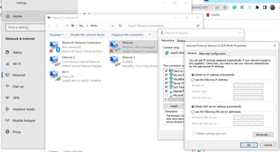

I can connect now with PuTTY but I keep getting 192.168.0.2 is not alive. I've verified the steps you laid out and i am following them and the images. Yet I keep getting not alive.
12-06-2022 01:04 PM
Hi @jasegb
Can you provide the IP configuration for the computer and the command
printenv for the switch.

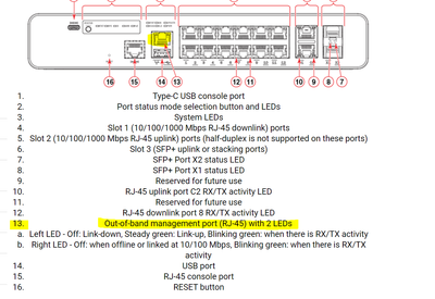

3:Ensure that Ethernet cable from the computer to the switch is properly connected, take in consideration that in the Switch is the management port and the computer will be the regular Ethernet port.
Port 13 in the next image:
Computer:
