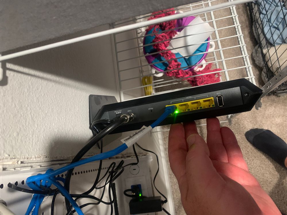

recently lost power to all 3 R510 ceiling units at  same time. Still have wireless internet to home but appears slow.
40 REPLIES 40

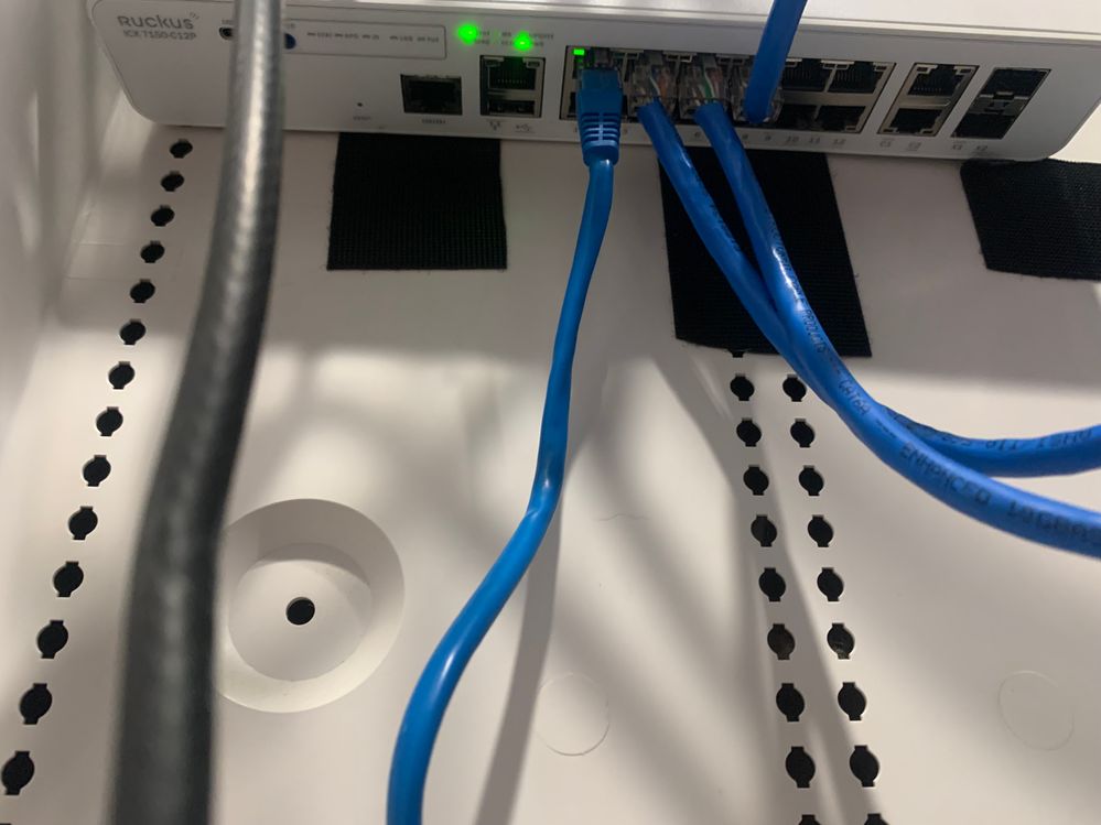

I connected ethernet cable from modem to port 1 and still no power. Please look at pics below and let me know if hooked up wrong. Thanks again!IMG_7506.jpgIMG_7503.jpg
Hi @busch007
This issue may happen when the Switch runs on the Routing code (SPR). The Switch should run on the Switching code (SPS) to avoid these issues for Lennar home users. If the Switch boots up on the other partition (Due to a power outage/power spike) which may be running on a ‘Routing Code’ results in causing this issue. To check the same please follow the below process..
ICX7150-C12 Router> OR
ICX7150-C12 Switch>
show version
show flash
show inline power
show interface brief
