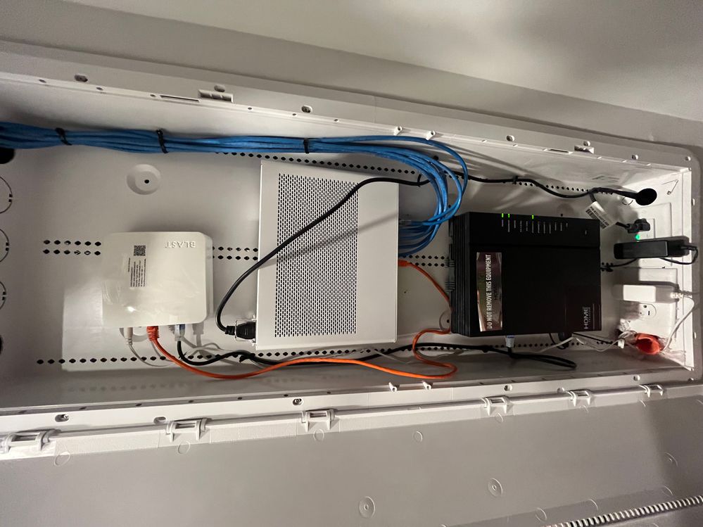

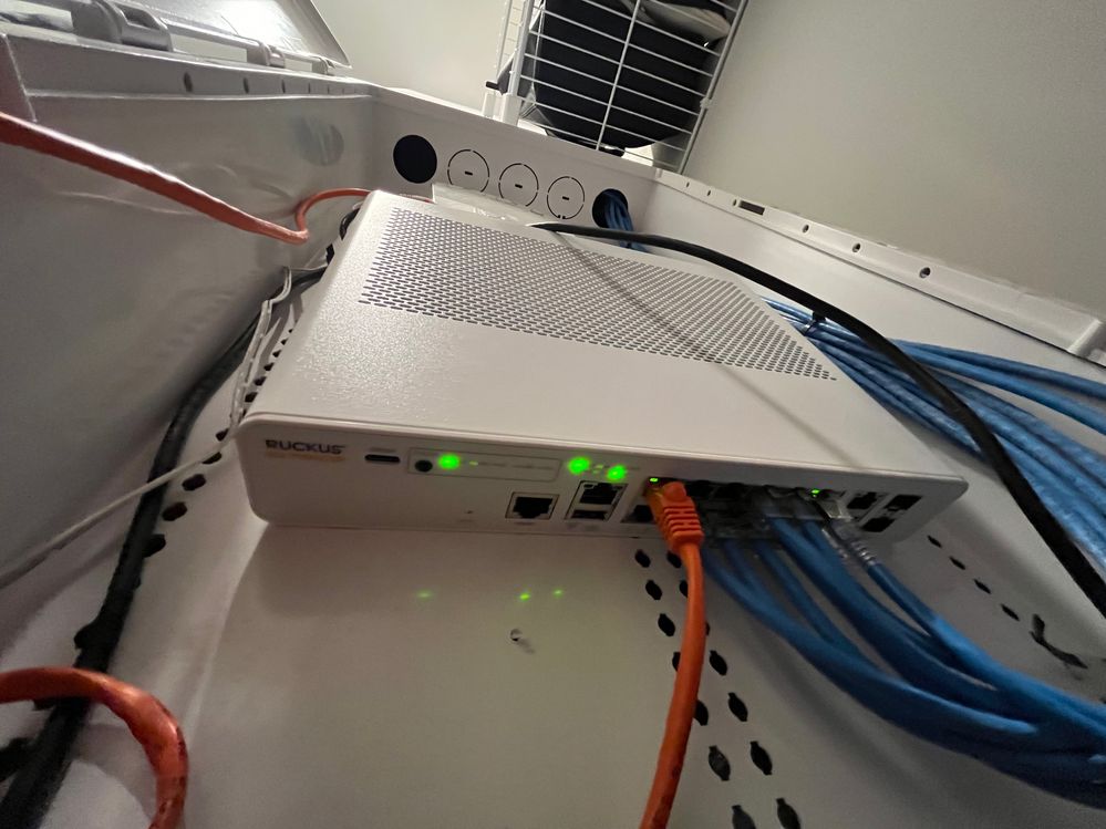

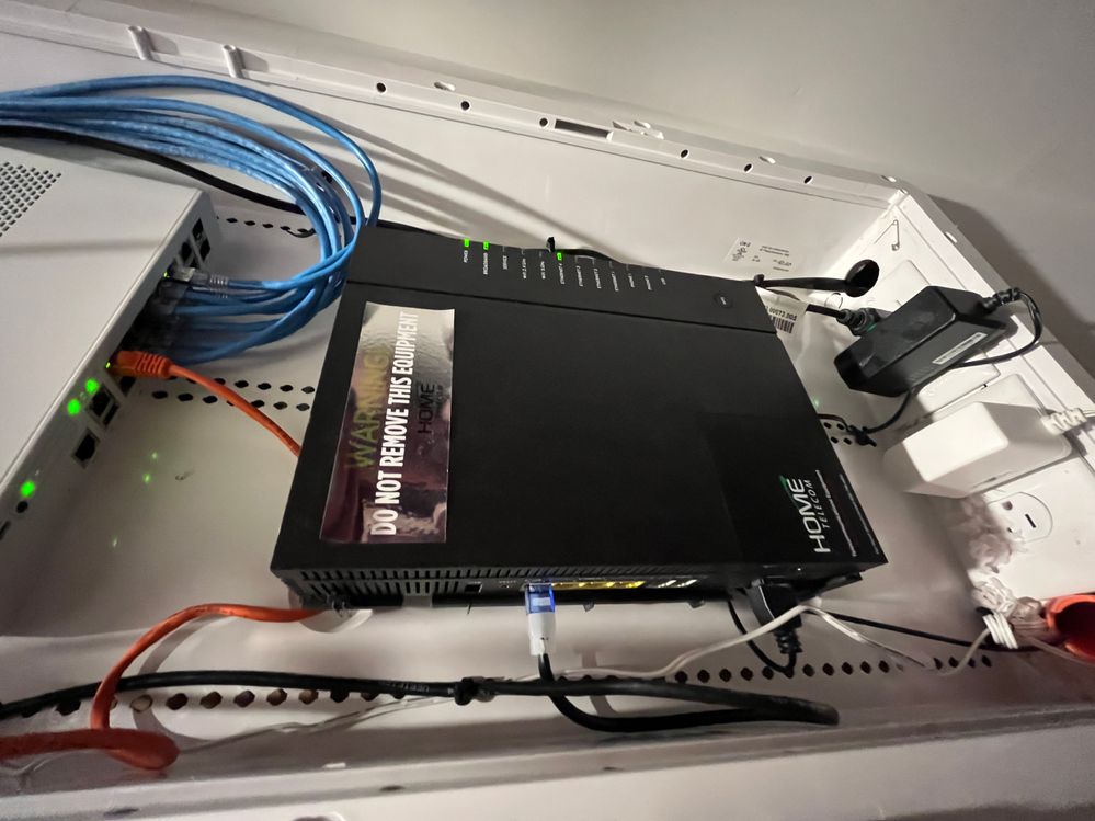

2. On your switch while it's plugged into the outlet, do you see any lights on? (Amber or green) Please let us know which lights are on. (Please refer to the below picture and share a picture of the same, showing the light status and the FULL Switch panel cable connections to the Switch ports)

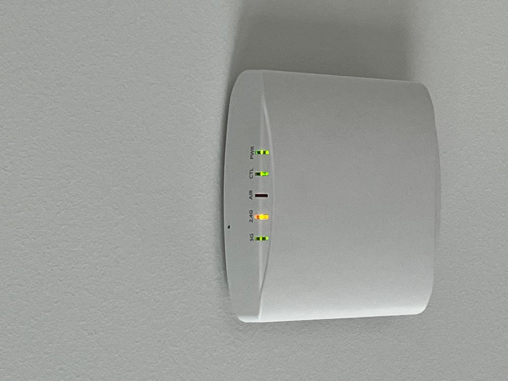

3. May I know how many Access Points are connected to the Switch? Could you please let me know the light status on the Access Points? Any of these lights are on (Please refer to the below picture and share a picture of the same)
1. I have no idea if it has ever worked. We moved into a pre-owned home and have only ever used the main router for internet. I factory reset both APs in order to configure a new SSID and have never had it work.
2. All lights are green on the switch. If you toggle over to USB the USB light is amber. All other lights are green.
3. There are two access points in the house. I disconnected 1 in order to configure the other - creating the master AP. Ive tried the reset process with each AP as the master. Neither is successful.

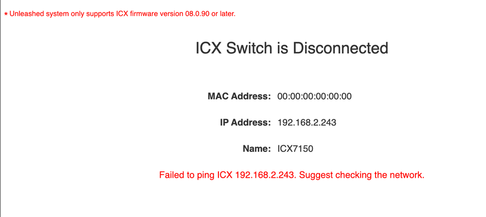

I was finally able to configure the master IP, and connect frequency. Once connected I can connect to the APs IP address and login into unleashed, via the web. Its now telling me the ICX is disconnected and cannot be pinged. I believe this is the problem. How do I fix this? How do I get the ICX connected.
Configuration of wires, lights, and screen shots below:IMG_2394.jpegIMG_2396.jpegIMG_2397.jpegIMG_2399.jpegIMG_2395.jpegScreen Shot 2023-08-06 at 2.17.26 PM.png
