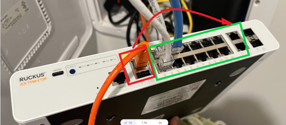

1. No light on
2. Is 1 light on the switch box
3 . nothing else
2 green light
pinky_ruckus
Valued Contributor III
Hello @Adelaide ,
From the pictures you shared, it seems like the ethernet cable which is coming from the ISP’s (Internet Service Provider’s) Router or Modem/Router combo is plugged into the wrong port on the Switch panel. It must be plugged into any 1 in-12 ports as shown in the below screenshot. Please unplug the ethernet cable and plug it into the correct port then reboot (unplug and plug from the power outlet) and try to connect to the Internet via Access Points.

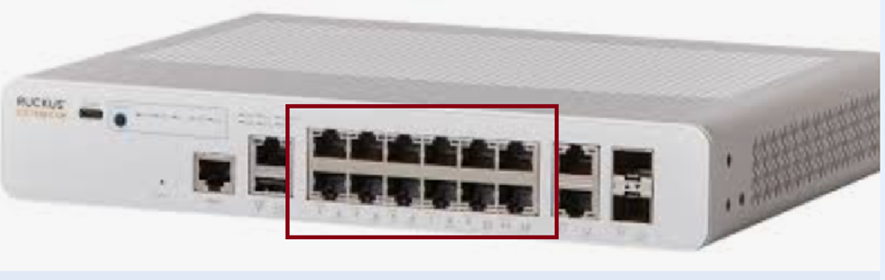

It should be plugged into one of the 12 ports as shown in the below screenshot.
